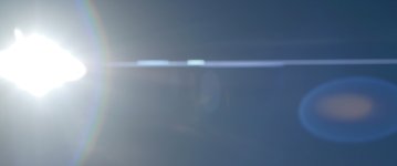

Finally my PL mount showed up. Now I can use my anamorphics! Here is my take on a digital directors viewfinder. Sorry, I got excited!

That flare looks really buff. When RED first announced that they were going to produce a pocket camera, this is kind of what I imagined.
