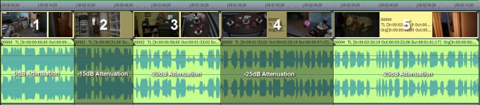

I agree with Ozpeter, the GH1 has a limiter and not an ALC. What the GH1 has is an extremely sensitive mic input that needs to be attenuated (up to 40dB with mic-level sources) no matter what mic or audio mixer (mic-level output) you use.
I've done extensive testing on this with various mics, mixers and attenuators. I did one test back in February using a Shure SM57 handheld mic directly connected to the GH1 and then adding an adjustable attenuator to the mic and measuring the peak and background noise dB levels and the change in ratio between the two.
What I found is that with no attenuator the audio was peaking at -3dB and the background noise was at -25dB. Adding 25dB of attenuation resulted in a peak level drop to only -10dB (7dB change) but a background noise level of -43dB (18dB change). Draw your own conclusions, but to me those numbers say that its a limiter and not an ALC. It also shows how hard the audio level from the mic was hitting the limiter without using the attenuator.
I did test an audio mixer output also and that needed 40dB of attenuation at its mic-level output (not line-level - I know what I'm doing here) to then input into the GH1's mic-level input. Once the level from a mic or mixer is properly attenuated, I found the audio quality from the GH1 to be very clean even if you needed to raise it back up 5dB or so in the timeline.
I did a test the other day with a Sennheiser ME-64 cardioid mic in a room with the TV on and was recording someone talking in that room. Without attenuation the mic and TV were both heard clearly in the room even though I was pointing the mic towards the person speaking and the TV was behind the mic. Once I added a 30dB attenuator to the mic the TV noise level shot way down compared to the person speaking.
The other thing is that the "limiter" in the GH1 altered the way the voice sounded without the attenuator which makes it sound over-processed. You definitely don't want the limiter in the GH1 to "color" your audio by it doing too much work to where it sounds unnatural. All you want the GH1 limiter to do is prevent distortion.
Here is a screen grab from that test I did back in February. I did the first 4 tests with a Shure SM57 handheld cardioid mic and the 5th test with a Electro-Voice RE50 handheld omni-directional mic just to double-check my results with the SM57. The RE-50 was a little less sensitive than the SM57 but the results were basically the same.
Randy
