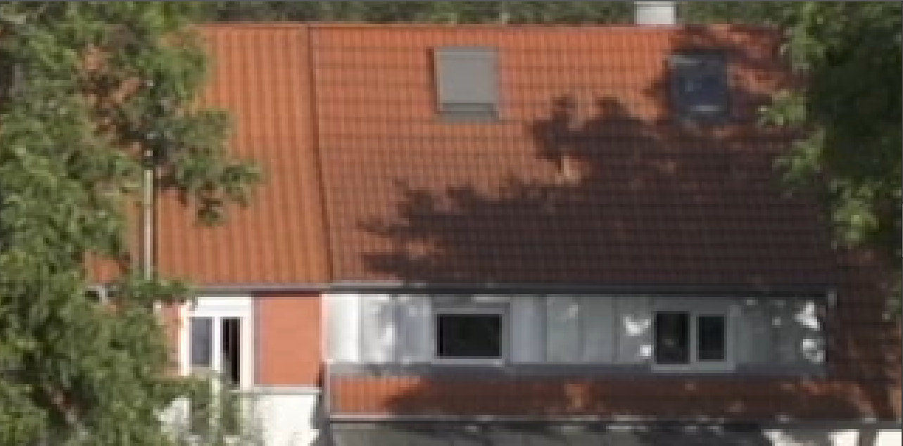

I tested different picture profiles today and I´m not sure how to get the best out of the camera.
So far I think cinegamma 1 and 4 are both good gammas. What you lose in the shadows in cine4 you gain in the highlights but, highlight roll off and noise is better with cine1.
In cine4 you get a small amount of knee-like color shift in bright areas while cine 1 rolls off really well. (I set knee to 105 ; 0)
Another thing is ISOs. Does anybody know what the base sensitivity of the camera is? In cine1 you get ISO 400, cine4 starts at ISO 640. I don´t want to use negative gain and reduce DR.
At the moment I tend to cinegamma 1 with cine colour. Detail -1 or -2 and WB shift one point towards magenta.

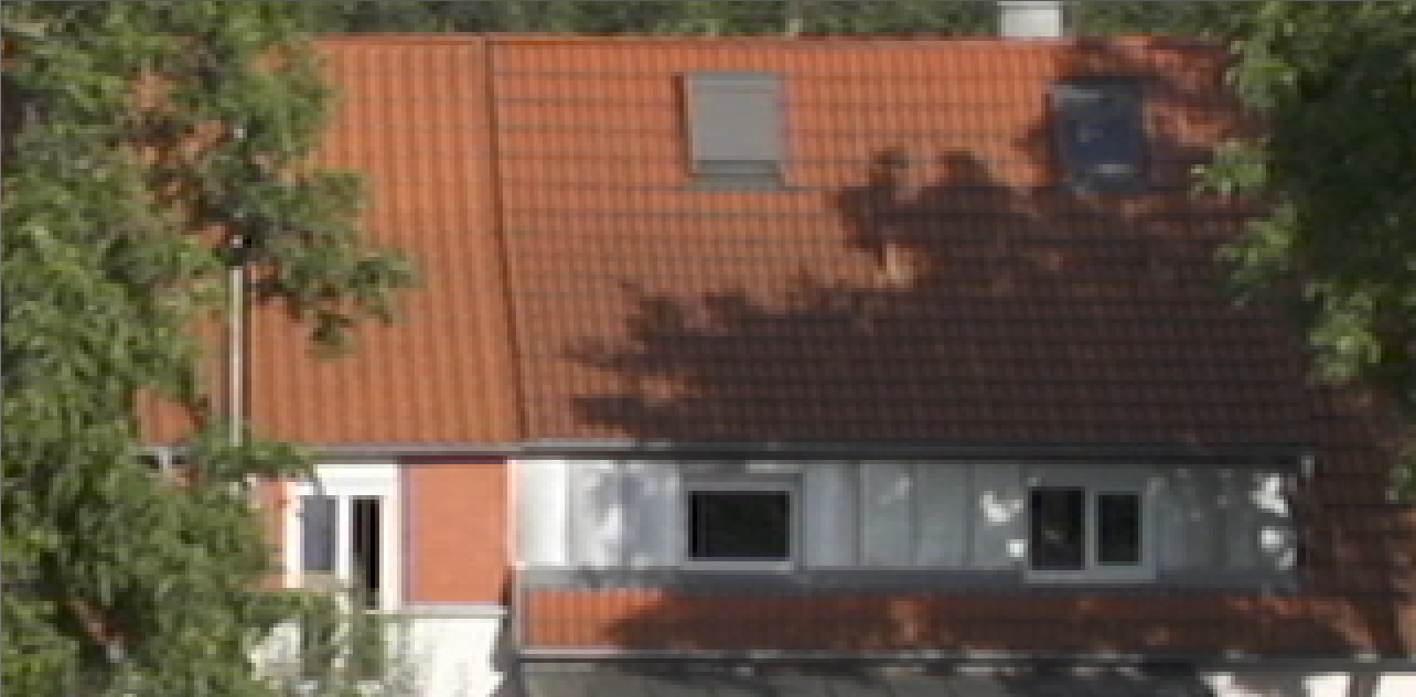

After some more testing i´m in a dilemma...while CG1 gives you an amazing amount of shadow detail with low noise and highlight rolloff from another world compared to the FS100, CG4 simply sees much more in bright areas just like film. But I find CG4 too noisy, in every ISO (not generally too noisy but for the specific ISO level) and the highlight rolloff generates a noticeble colour shift, far not as bad as ITU709 with knee but it´s there.
