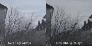

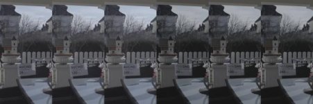

I did a small test to compare the internal AVCHD vs the Odyssey 7Q 2K DNG and got some impressive results.
The O7Q not only keeps the same 2K DNG sharpness from 24, 120 and 240fps it also shows a much higher detail compared to the "digital" looking internal AVCHD (no sharpness applied).

The amount of detail the O7Q delivers is pretty the limit of Full HD!
Thanks for posting. The difference between AVCHD and DNG is quite noticeable. I'm glad the 240 fps video looks so good.
The 24 fps is visually better than 240 fps in stock mode. I'd be curious to see 1080 at 24 vs odyssey 2k at 24, If you can post samples that it would be great. Thanks for the post
