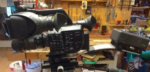

If you are lucky enough to already own the FS7, the LCD/loupe works great when rigged to the FS5. Many options and ways to do it.
Here's what I use.
That looks bigger than the camera :) Ergonomic wise looks like you would be holding the camera way out in front of you.
digital post can you still attach the top handle with that set up?
You could set it up anyway you like. That is a dove tail with sliding lockdown clamp. Sounds like your preference would be to attach the dove tail more towards the front of the camera. Plenty of ways to skin a cat. You could also side mount it with handle attached. I'm sure someone with come out with a loupe that fits the FS5, but in the mean time - this allows many mounting positions, plus back and forth, left and right flexibility even after its mounted.IMG_8599.jpg
