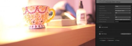

Just been doing some tests with my new FS5. If I shoot in PP8 it looks like S-Log through the LCD but when I import it into FCPX it has a baked in look, like a LUT has been applied. Unusable.
I just tried PP9 and all was fine, what I was seeing was what I got when imported. I'm mega confused, hoping it's just those middle of the day sugar downs that are causing a malfunction in my head and not the camera!

Select the clip in the browser and then check in the inspector to see what the Log Processing setting is for the clip.
FCPX has applied its own LUT.
If you want to do your own thing just select the clips in the browser and change Log Processing to None.

Yes, 10.3 looks at the metadata from the camera and applies a LUT on your footage. I haven't tested this myself yet as I haven't imported anything since updating to 10.3.

that's really strange in FCP 10.3 . Also in the import window I have a LUT preview applied.
I couldn't find a check box to turn it off neither in the import preview nor as standard when imported.
The internal LUT does not match if your exposure is 1000EI
