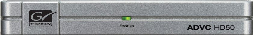

Wow! I wonder if this would really work. Have you tried it? I know Wirecast has a plugin to allow HDV in. So I guess, at least HDV can be carried live over Firewire. Impressive if this box could take the fs100 footage and convert to HDV on the fly.
