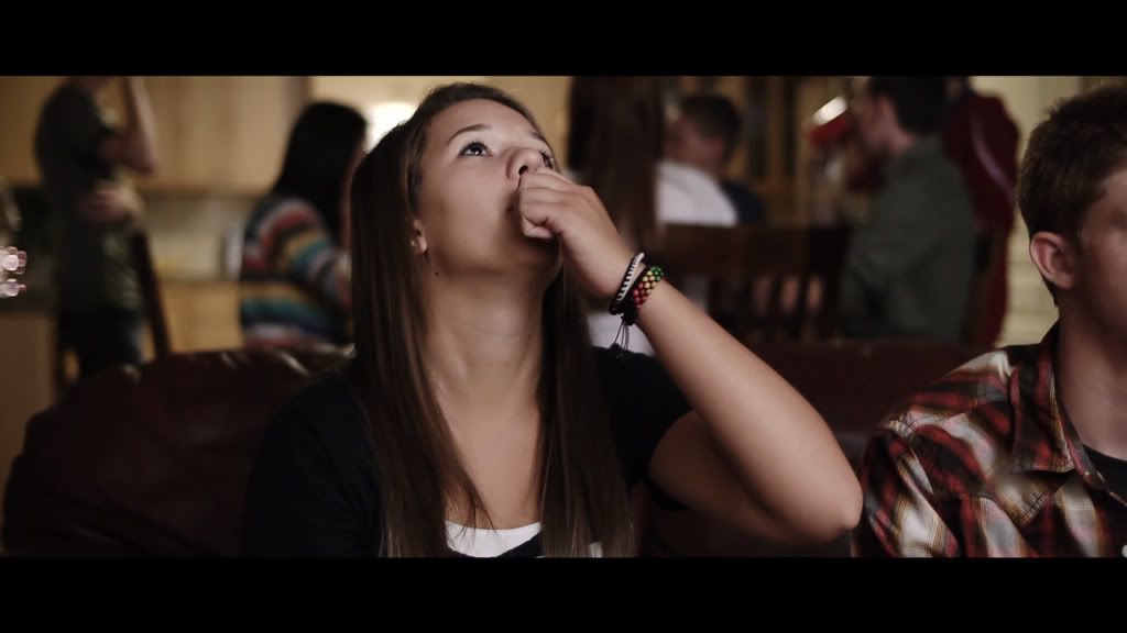

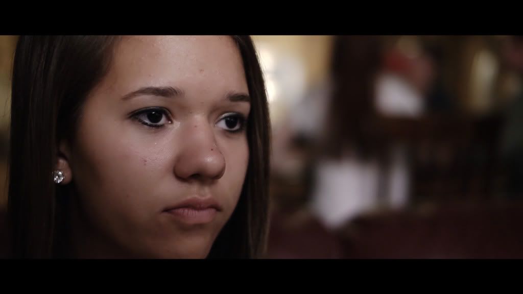

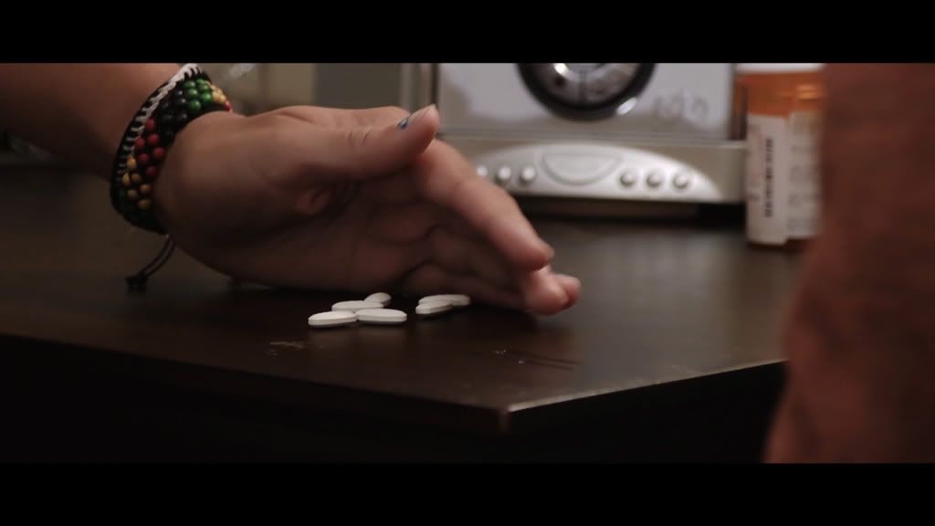

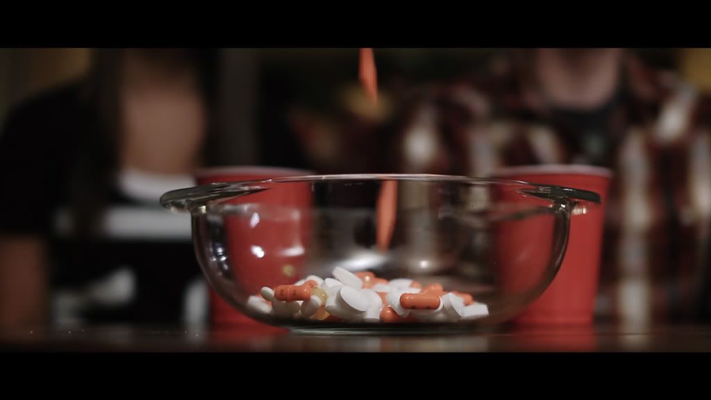

A few frame grabs from tonight's anti-drug PSA shoot with a quick and dirty grade and crop on them. Came out pretty nice, let me know your thoughts!
(PS) What is the correct % from top & bottom using the PPro crop tool for 2.35? I seem to remember it's 12%, but not sure.
On a 1920X1080 frame, cropped image should be approx 1920X816 (sometimes 820).
Grabs look nice... looking forward to seeing it in motion :)
IMO it's much easier to make a transparent PNG with the bars already on it and put it on top of your footage. That way you can easily adjust the shots up and down to fit the proper framing you want if there's anything you want to change.
Looks great btw, top notch.

I thought 2.35 was dead and 2.39 replaced it (but it's still called 2.35)?
If so, 1920x803 (12.8% crop top and bottom)
1080/30p HQ (1080/60p Bowl Scene)
Detail: 0
Detail V: 0
Coring: 0
Chroma: -2
Phase: 0
Master Ped: -2
DRS: Off
Gamma: Cine V
Matrix: Norm 2
ISO: 400-800
Aperture: f1.1-f4
Shutter: 180 deg
Lighting: Ambient + 650/1k bounced off of walls
Looks great, Andrew!
I'd never guess this was shot with Detail at 0, it seems softer and more filmic than I tend to think of 0 Detail.
