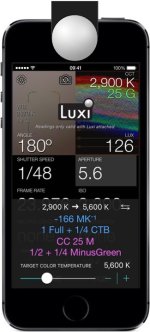

That's a great idea. And if you want to get your head around using a light meter and have an iPhone, you could check out Adam Wilt's genuinely useful Cine Meter II:
"Cine Meter II turns your iPhone®, iPod touch®, or iPad® into a reflected light meter, an RGB waveform monitor, and a false-color picture monitor. Cine Meter II works on any iDevice with a camera running iOS 6 or higher. It expands the original Cine Meter app..."
https://www.adamwilt.com/cinemeterii/
Cine Meter II doesn't replace the need for a very good light meter, but it's not a toy and is a great and (if you already have an iPhone) affordable way to start learning more about light.
