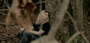

In the final shot of the girl in the forest... ugh... leaves in the way... If you do want to have 'leaves framing' the subject, you need to make sure the face of the subject has a clear shot. There seems to be a twig hanging down right through her face... In terms of cinematic language... the use of such a shot is to perhaps show 'someone is lurking', and we have the voyeristic Lurker's POV, or perhaps show 'isolation/aloneness'. In either case the leaves just aren't enough to carry that sort of coding. In terms of exposure, the black blouse pretty much has no detail. That's a problem with 'black' unless lighting brings out the detail, it often ends up reading as just a 'cut out'.
As a note, in more 'action shots', such as tracking a person running through the forest 'crud' can get in the way of the shot... but it is momentary... when the subject pauses, for some 'dramatic reason', the camera needs to have a clear shot, or if in the 'predator mode', the camera moves, hunting for the 'best view', crud may show up momentarily occluding the subject, but it's not a 'long static' shot of them looking over their shoulder...

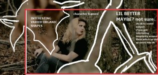

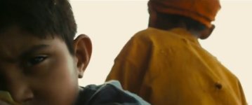

Below is a shot from slumdog millionaire its a shot anyone can get with any camera (image quality aside)-- its about using shapes in an interesting way, it sucks cause most cinematography books really don't teach it fully, tho they give you lil hints like the rule of thirds. 5 C'S does has some super useful info itll get you started on that road.-- work hard for your shots, literally get on your knees, get up on a chair, zoom in super close, etc.. Try to make the shapes in your frame do something interesting - also use common sense a touching love scene doesn't need a dutch angle, etc.. the foreground trees is a nice start keep going might take a while to learn takes practice and constantly looking at well composed images its a lifetime pursuit right

ps the pic you did below is not a terrible composition-- its actually quite decent. thats why im not using camera movement right now, and focusing on learning to get well composed not moving shots.
