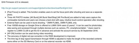

I saw this for firmware 2.5: "[AF-ON] function can be used during video recording."
Anyone test this to see what it does yet?

I've not upgraded mine yet, hopefully someone can elaborate on what "[AF-ON] function can be used during video recording."
