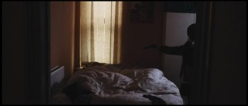

Here is a shot 'as shot' and how it is looking in the grade.. there is of course little noise in the shadows after such a crush..

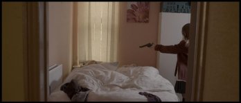

Here's my go at your frame Sam but simply using the built in tools in FCP X. I was too lazy this morning to fire up Davinci Resolve.

I would agree with Sam's approach. I prefer to expose for a "fat" negative and work with a darkened LUT giving more flexibility for later. If some aspect of the frame needs a shaping in the grade, you have room to do so rather than having the look fully baked in. In Sam's example, it would be reasonable for the director to say "I can't see the gun and I need to" and you can lay in a window that would simulate a little gradation across the wall, picking out the gun. If the image had been exposed in a way that was close to the final grade, there would be no room to do so. I'd give it anywhere between a half stop to a stop of extra exposure.
