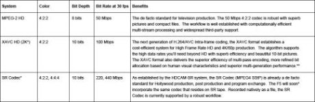

Here are the codecs and RAW options offered by the new F's:

Wow, seeing it in the table really shows the vast options available. It has similar options to the C300, Alexa and Epic.... combined.
