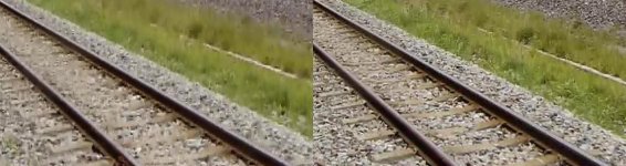

just uploaded to megaupload the first 50 frames of this video, of course pulldown removed, and saved as jpgs.
http://www.megaupload.com/?d=8AB7AYPR
pay attention to frames 1-12-24-36-48
the point of this post? may be we can only post here how good is the gh1!! :beer:
I'm thinking about purchasing this cam and want to be sure I can shoot foliage at 24p, so I'm downloading every m2ts I find, in another m2ts I saw also strange effects with moving foliage , may be the gh1 is a urban camera!
Thanks for the upload DrBlaz. I haven't checked it out on a TV but I'm guessing the effect would probably be a bit distracting. For people that don't have the patience to step through the images, here's a side by side of frame 11 next to frame 12. Frame 11 is mushy, and on frame 12 a lot of detail suddenly pops in.
In all fairness, it appears the shutter speed was pretty high here, and if it was more in the range of 1/50 or 1/60, the motion blur would help to cover up this effect. That doesn't make me feel any better about the codec, though.

Well...that's not what I was implying. There are other threads with plenty of examples and info on why this is happening. when I opriginally read this I thought it had nothing new for me to learn. But I admit I didn't see that you were talking about a specific mts file. But if it's the file codeloss is referring to then that is the same one I was talking about in my original reply. It's strange how the other 1080 files look good with movement though.
And that is the secret. Unless we have information and all the details of how they were shot we have no point of comparison. So it becomes futile to try to make a good judgement unless you were doing tests with your very own hands and eyes the way Kohli and Hunter are doing and the way you will be able to do the day a camera is in your hands.

It should. Unless your standard is uncompressed RED footage, in which case what you really want is a RED One, then you're going to be working with compressed footage.
The job of a codec is to reduce 500MB/s or so of image data down to 17Mbps so that it displays well to someone watching it at 24 or more frames per second.
I expect that when watched at that speed, this footage looks just fine.
If you're looking for the "film look" then you're going to be shooting at a shutter speed of 1/48th (or 1/50th) and you're going to get motion blur.
Looking at these frames, this codec is unable to keep up with the movement between frames in exactly the areas your eye would blur anyway-- characteristically the highest movement spots are also the ones least well rendered and that would be totally blurry in a film camera.
The important areas of the footage-- the background trees, and the train, are all rendered fine.
If this were shot with a film camera, the pebbles and the grass by the side of the tracks would be blurred in every frame.
This codec is actually giving you a higher quality image than you would get with film in the same situation-- where all that stuff would be blurred.
If you're not wanting to make movies-- but are instead looking for a 500MB/s image quality with perfect resolution in every frame, then this camera is not for you.

I've seen enough footage, and downloaded enough files (like the frames uploaded here) to reach this conclusion:
Anyone complaining about 24p mode in this camera is not being realistic. IF you want to complain about 24p mode, show similar images from a similarly priced camera in a similar situation with similar settings that hold up better.
Without that, its just nitpicking and near as I can tell, always unrealistic.

Totally disagree with this. Blur and COMPRESSION artifacts are two different things. A straight MOTION blur will not look like this on Film.
If that's how you placate yourself, then okay, but this is in no way fact.

Kholi: I think you misunderstood Liza; she said that film is usually shot @1/48, while the footage shown on watchimpress had a faster shutter speed, thus trying to get some crisp footage (hence breaking the codec) where film would have simply shown blurred area (which the codec can handle way better).
.... but using 60p all the time in a 24p timeline, that doesnt work for me. Sure if you want everything to look like Gladiator's fight scenes
How do you come to that conclusion? 60p has nothing to do with the "Gladiator" look. You are refering to fast shutter speeds not frame rates. Just shoot your 60p at 1/60 shutter and you will retain your "film-like" blur.
