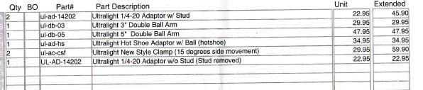

Thierry, Could you detail which components you used to create the UCS mount and where did you purchase? They don't seem to have prices on the web site that I can find.

Sure, here is a scan of my invoice. There are a couple extras to make this truly versatile. On the EVF, I think it is best to use the Ultralight 1/4-20 adaptor w/o stud and use a 25mm long Hex screw accross the cheese stick. This will prevent any spin. I am also modifyin a Manfrotto clamp so I can set it to the front of the F3 handle support and have the Ultralight ball stud in front of the handle. A side not on using the F3 hot shoe. It works but I think this is quite weak. Not recommended IMO.

Filmtools carries the UCS products but they will charge you an insane $50 amount for ground shipping :Drogar-Shock(DBG):. I bought my stuff from www.backscatter.com, very prompt service and 1-3 day UPS is free for orders over $200.
