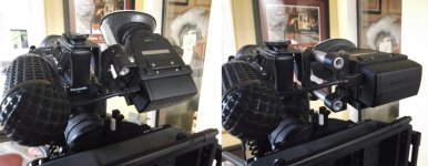

The problem with most of these accessories is that they are designed to be universal - that's a plus from the manufacturing POV, but not so good in daily use. Almost anyone who has been doing this for a while has accumulated bits and pieces like rod blocks, 15mm rods, etc. With 2" angle aluminum, available from almost any hardware store, you can use simple hand tools like a drill, hacksaw, files and taps to use these pieces to fabricate something much better, custom fit to the AF100.
The one I made is solid, doesn't add height (so it fits in a case without disassembly), moves far enough forward over the matte box for balanced handholding, and, by sliding it back on the rods, will tip up to clear the matte box for tripod shooting. It's not rocket science.
And if you don't have the pieces, google 15mm rods and see the inexpensive stuff that's available (I wouldn't use these for a matte box, bvecause they're cheaply made, but they're fine for an EVF). You should be able to make something in about 4 hours for way less than $100.
Here's a pic, it's simple and works better than anything I've seen. I'm using a Cineroid here (I prefer it for handholding because I can turn on red peaking without going into a menu) but I have rods on my Z-Finder Pro too, so I can swap them quickly.
