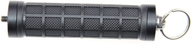

And something else I did. So I wouldn’t have to steal the tripod/extended handle of the RS2 to use as the handle for the ‘briefcase handle’ attachment(which is DJI’s design/intention), I bought a rubberized handle with a 1/4-20 stud from Camvate to use just for that. Less than $13 from Amazon(same $ as B&H, but shipping is way quicker, now).
https://smile.amazon.com/gp/product/B014WIO2MC/ref=ppx_yo_dt_b_asin_title_o01_s00?ie=UTF8&psc=1
