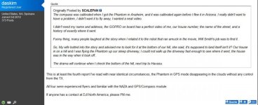

Another day and another user reporting a fly-away meeting with DJI denials this can happen.
Also, from a few days ago, I noticed an RC forum member pointing out failure reports are coming from experienced quad flyers.
