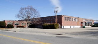

Here are a couple of shots I thought you all might enjoy seeing. It is the Igus facility in East Providence, RI. The location is only 5 minutes from my studio.
