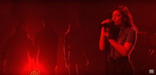

I have a canon xa25. If I film someone on a stage with not much lighting the band behind them has big blocks of digital noise. Here is a screengrab from the SNL performance. the singers in the back aren't lit that well and you hardly see any digital noise but when I try this there is big blocks everywhere over the video. Even more strange is I can't even get an image as bright as the SNL screengrab without turning my gain up to like 15 which is odd.
Even more strange is with my f stop all the way open the highest luma value on the waveform in premiere for skin tone is at 35 IRE which makes the whole picture dark so I have to crank up the exposure in the Lumetri panel.
DLD is right, you are comparing your $2,000.00 consumer camera with a tiny 1/2.84" imager to professional $80k - $120k cameras with significantly larger imagers (I tried researching which stage cameras are used on SNL but couldn't find anything other than they were evaluating 4k cameras back in 2013 so they probably went with some kind of nice 4k camera, Hitachi, Sony, Panasonic or Ikegami). I interviewed SNL DP Alex Buono a few years ago but it was just about what he uses for the open and all of the insert segments when they do commercial spoofs and other inserts so it wasn't the studio stuff, he has nothing to do with that.
What you are seeing on your camera is a tiny, realtively noisy imager with a low signal to noise ratio and what you are seeing on the NBC cameras is a much, much higher end camera with a bigger sensor and a much better s/n ratio and DSP. Keep in mind also that you are seeing the SNL output on your consumer television set or computer screen that has been through multiple compression generations, if you were in the SNL master control looking at the image on one of their 4k monitors, it would look MUCH cleaner than what you are seeing at home. it's simple, you are comparing horsepower and 0-60 times between a Kia Elantra and a Ferrari.
Another factor is that exposure isn't always what you think it is. That Lorde performance above apparently is low lit, but if you were there in person with a light meter on that stage, you would find that what looks like low light is often pretty brightly lit, they just iris down the cameras or otherwise treat the signal to look low lit. I once shot a dance film for a talented director and I could not get him to understand that we needed to light and expose the dance sequences correctly, then he could drop the blacks and levels in post to look dark and mysterious. He inisisted on me radically underexposing the signal as we shot the performances and the end product ended up being noisy mud as I told him it would be. This has been one of my most challenging tasks as a DP, trying to convince producers and directors that what you see with your eyes and on production monitors isn't what you get. Try to shoot Log on a not LUT monitor and see what happens with most directors, they freak out and think it looks like hell, when we all know that correctly exposed log is usually going to end up looking better than any baked in look because post software and LUTs are more sophisticated and capable than most in-camera processing. Most DPs and gaffers have ran into this. There are reasons to underexpose occasionally but you typically end up with a much better result exposing "your negative" (your camera's sensor) correctly and doing special effects in post, especially on low end cameras.

Exactly. Plus, on a multi-cam production like the SNL, one can easily mix multiple exposures. (+ multiple apertures + multiple everything). So, one camera is at T2 (as an example) wide and close and another is T5.6 and further away and each camera aims at a different performer on stage, each of whom may stand under different lights.
