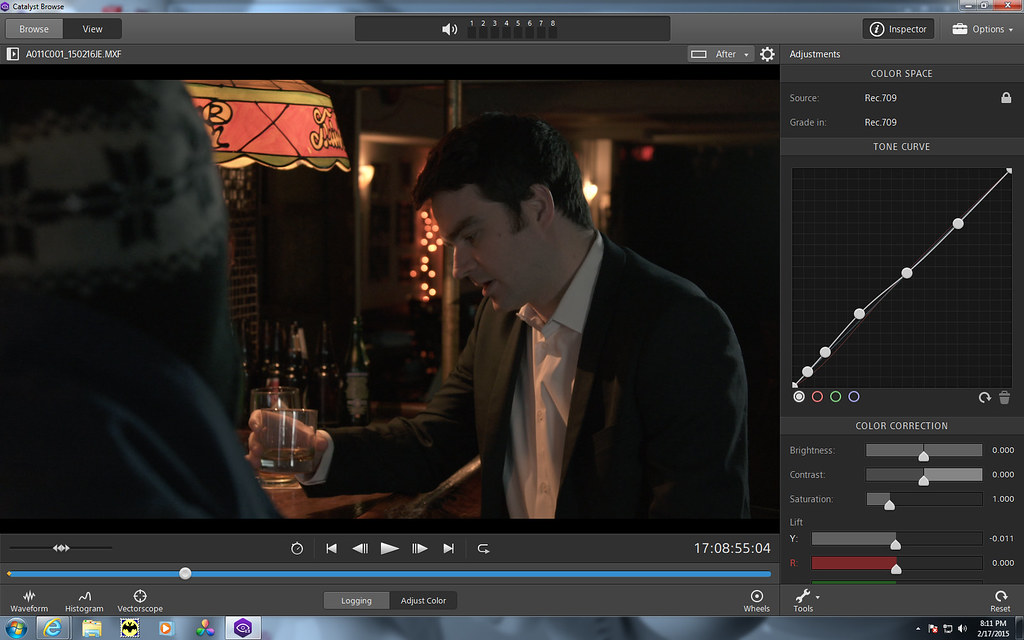

Shot a rush job the other day where footage was handed off to producers at the end of the night so chose custom mode for ISO/gain selection in-camera, as well as white balance capability. They told me "no grading" up front.
This is HG7 ISO 2000 with minor tweak using Catalyst Browse. It's not bad I guess. I wish I had thought to sneak a couple seconds of slog3 s.gamut3.cine for playing around later but didn't.
I gave them a copy of Catalyst Browse since they will need to do their own transcoding, so currently I'm seeing if they will at least take a few CDL exports from Catalyst Browse I can create to "tweak" the footage a bit. Hopefully they will go for it.

I didn't have any real reason to shy away from CineEI mode with LC709A baked in, I just thought for this particular project I would give HG a whirl. Plus on the F5/F55/FS7 the HG7 has the same dynamic range as the F3 did in slog mode (800%). So I wasn't too concerned about dynamic range or anything. Also they weren't exactly looking for a specific look, in fact they had been planning to shoot it on a GH2.
Here is the tweak to the master gamma channel and as usual the red channel pulled down a bit. I think I did a small green channel adjustment too.

Nice jog Dennis, looks good. Since you were in Custom what color Matrix were you using? My "go to" is Cinema at +40.
Thanks Bill.
Matrix was set to off. The F55 has a bit different set of matrix presets and I don't think 'cinema' is included. One matrix that I liked with the F3 was the FL one, it rendered bright light sources like the sun setting in the sky very nicely.
I guess another reason I opted for custom mode was because I wasn't sure what color temps I was going to run into with any of the existing lighting, so being locked to three presets in CineEI mode wouldn't have given me the flexibility I needed. Other scenes included office space and a washroom with overhead flo's, etc..
I really hope to see the color space updated in custom mode or WB options come to CineEI mode.
Totally forgot the 55 has different matrix presets. Yup, anytime I want to burn LC709A and the client wants it handed off and says there will be no grading or correction, I start leaning towards the Hypergammas if the lighting is mixed. Please.... Sony, WB options in CineEI
