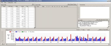

I could record without recording speed error. But, when I played the movie on computer, it seemed that the movie was flickering somewhat.
So I analized the movie files and found that the file was not perfect. Like the "picture 1", there are blank frames.
Picture1 : stream parser shot (tripod recording)
I think that blank frame make the movie flickering. Because of the flickering the quality of the movie is lowered, and the merit of the 24P mode was lost.

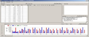

When I record the pappasart chart on hand held, the blank frame occurred less than that recorded on tripod.("picture 2")
But there was blank frames occurred as ever.
Picture2 : stream parser shot (hand-held recording)

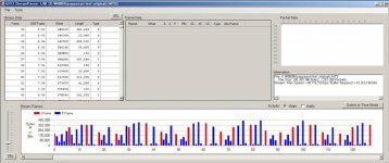

I supposed that if the bitrate is too high, the blank frame occurrs. So I changed the Video Bitrate FHD/SH=253000000, Overall Bitrate=25500000.
But the result was same as ever. (Picture 3)
Picture3 : Video Bitrate FHD/SH=253000000 (on tripod recording)

I could record the pappasart chart for 5 minutes without recording speed error.(on tripod) So I recorded the complicated situation (full of grass ground).
