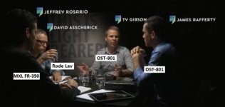

I recently did sound for a 13-episode TV series now playing on a global satellite channel (3ABN).
We had four guys seated around a 4-ft/1m square table, each with a lav hidden under his shirt collar.
The first episode is up on Vimeo here:
See if you can guess which mics I used on the different guys:
Ty Gibson, James Rafferty, David Asscherick, and Jeffrey Rosario
You can see the identification of who is who in the tags in the first shot after the opening sequence.
Here are the mics I used (NOT in the same order as the names above!
They were all wired, XLR mics, not wireless. Even though they are all runners, we managed to keep them seated long enough for each 18-minute segment(!)

OK here is the revelation...
Ty Gibson (gray shirt) and James Rafferty (blue shirt) had the Oscar OST-801 mics.
James Asscherick (plaid shirt) had the Rode Lav, and
Jeffrey Rosario (charcoal sweater) had the MXL mic.
