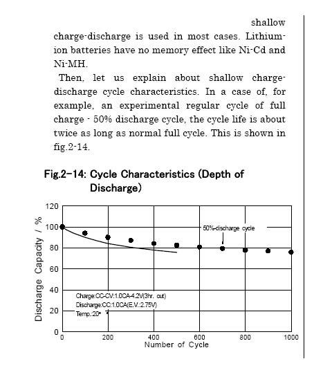

Here is a little more information. I extracted this from the Sanyo Li-Ion Engineering Guide, which is widely used by design engineers in the battery industry. The graph shows how the cycle life of a battery gets shorter with deeper discharges. The solid line is full discharge, resulting in about 80% of its original capacity after 350 cycles. The dots show about 700 cycles for shallow 50% discharges. It is clearly better not to run a battery down if you want it to last longer.
