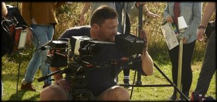

The camera SDI was fed into a Black Magic Hyperdeck Shuttle using the HDMI out of the Shuttle to feed Sam's onboard SmallHD_DP6 hdmi monitor, the SDI out of the Shuttle to feed the directors monitor. "The looped monitor setup did not cause any latency issues which was most pleasing."
A Hawkwoods breakout box fed the onboard monitor, the camera and Shuttle. "Usually with a single battery change at lunch time - when we also swapped SSD so that the DIT team could ingest the mornings work while we shot in the afternoon"

"We did some shots on a small jib arm, for that we stripped the camera back to keep the 'head' light and simplify setups; the small size, low mass and onboard battery made such shots simple with the BMC - I love the concept of the 'removable camera head' where the camera is split to keep the sensor and lens almost separate from power monitors and all the other bits. Such a split is really only available by using a BMC or an Alexa M at a far higher price point"
