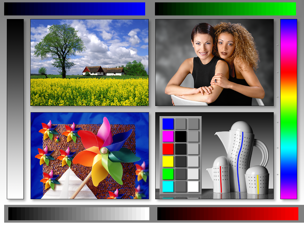

Heres a basic: explanation of grey scales and the value to the D.P.
Even though these 2 links are about Monitor management...it should not be difficult to translate it to exposure in a camera using a grey scale card by thinking backwards a little.
(Forget color for the moment.)
http://www.ivan.co.nz/ColorManagement.html
http://www.ivan.co.nz/Color management/Monitor.bmp
Heres the idea:
The grey scale represent the full range of tones in an image . (Grey scale is far more important than color. You cant control the color as much as the grey scale - tones)
If you expose a Grey Scale correctly (perfectly) you will see all the greys in the chart. (over or under expose either way and you see less of the greys at either end accordingly)
Understanding the grey scale then takes you to being able to control it. (With Lighting + exposure). It is absolutely legitimate to under or over expose (shift) any area of the grey scale ( except you must protect your whites ie they have an absolute upper limit)
Thats why a Grey Scale chart is useful.
A grey card has different functions. Its about the mid tone exposure. ( Gammas) The grey card correctly exposed sits in the mid sections of the grey scale and the wavform show this.
THey are also useful as a set up for Colorists.. The grey card is color neutral and should display on a vectorscope as such. ( ie a dot in the centre of the vectors). If it displays other wise...the colorist can dial the color out so that it does. This dial out will reflect in the images that you have shot also if the colorist uses the same dial in as the card.
Grey scales and grey cards need to be shot in controlled perfect conditions ( color temp /exposure. Not randomly under weird color temps or badly exposed..
Hope that helps a little. There is a lot to this subject. Color charts are another whole ball game.
