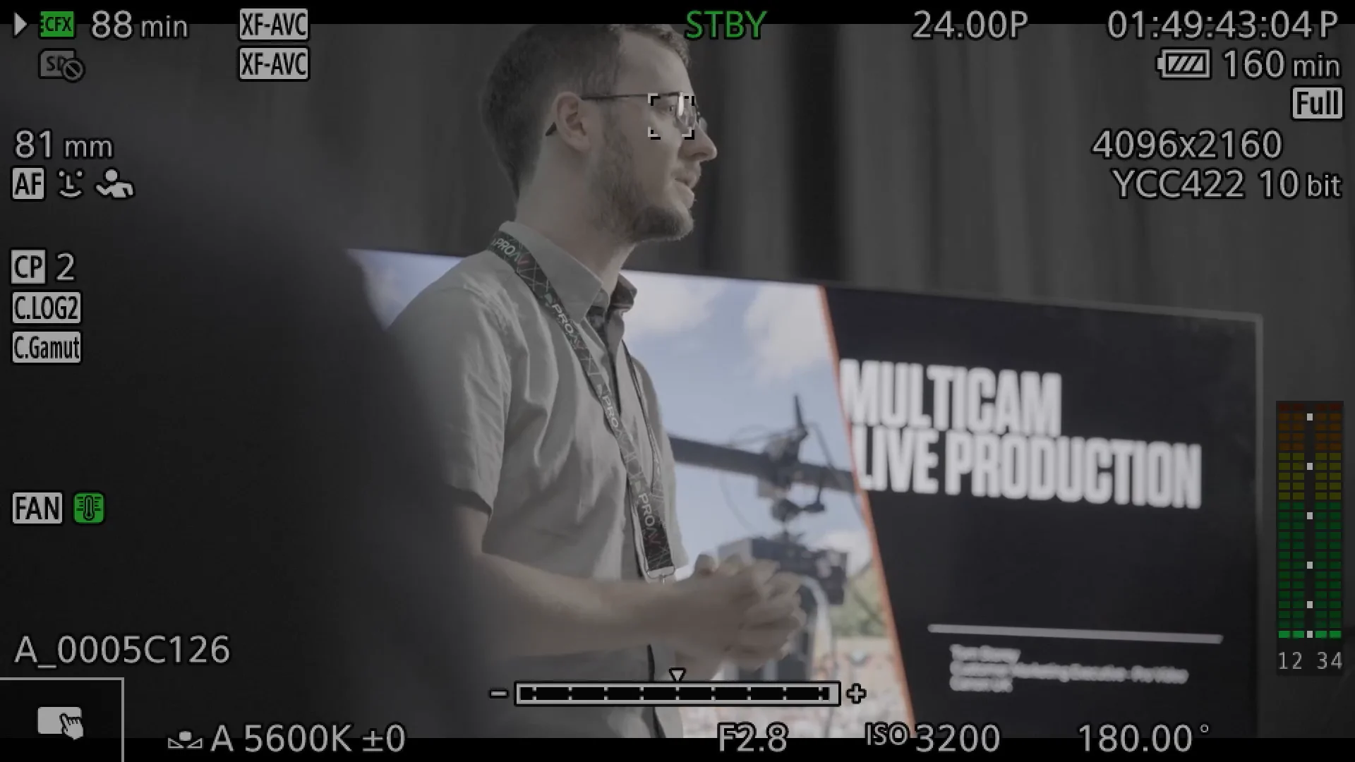

Ive been sitting on this for a while as Ive been too busy to look and I dont think the subjects were too happy to be filmed and I felt I need to like read the menu.
Pro Av canon day.. they chose the perfect set up.. an unlit shed with a few lights causing distration.
25p timeline so 50p is 'slo mo' (a situcation I would use to grab broll at a corporate horror) lense is 24-105 f 2.8
