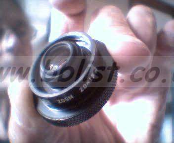

I have just bought an Angenieux 1.5x teleconverter in C-mount. This will increase the projected image circle on my lenses, reducing vignetting right? It looks like a really nice teleconverter and I've never seen one on Ebay before. Paid £30 for it.
I have just bought an Angenieux 1.5x teleconverter in C-mount. This will increase the projected image circle on my lenses, reducing vignetting right? .....
Well, that's not the intended purpose of a teleconverter. It's designed to magnify the center of the image, as if you had a longer focal length lens. I suppose there's a chance it might show the edges of the original image, which would fall outside of a 16mm frame, but it's only designed to cover the area of a 16mm frame. Anything more that you get is purely by happy accident. Maybe you could get an inexpensive C-mount lens and test it, then let us know what happens. (Hey, if this really works, I've got some Switar lenses for my old Bolex H16..... hmmm.)

Well B4 ENG lenses cover the whole AF100 sensor with a 2x extender on so I assume it is the same with C-mount leses? I have a Canon TV lens on it's way which has minimal vignetting on the M4/3 sensor, hoping the 1.5x extender will cover the full frame.
Also hoping the angenieux will retain sharpness better than other extenders.

Just paid for the 1.5x tele and have a c-mount lens arriving today. Also looking to buy an angenieux 12-120 or 15-150 to try out. I have added a picture of the teleconverter I bought. Never seen one made by angenieux before so I hope it's good!
The Canon TV lens I bought is used for CCD cameras I think so it will have colour fringing which is why I'm on the hunt for lenses designed for 16mm film.
