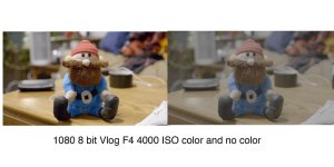

Here are some photo samples.
Hi Norbro, thanks for the reply. Yes, I used V-log on the GH5 and GH5s often, but they performed better than this brand new S1H surprisingly. The Gh5s had lots of noise issues that why I sold it, lots of people were complaining about it. I could NOT even shoot VFR without noise on the GH5s.
Here is a quick photo I took of before and after a very quick grade.
IMO, I think there are very few cameras that will look as clean as you're hoping at 4000.
You're most likely doing everything correctly, and it's just simple underexposure that is pronouncing the noise. Very common...

Could you upload the stills to google drive or dropbox and link? They're coming in at too low a resolution here to properly evaluate.
Also - did you shoot the v-log in 8-bit?
It sounds like you're shooting without any noise reduction (the default setting in v-log), which may partly explain its poor performance relative to other cameras that typically use noise reduction by default.
