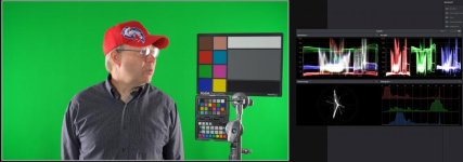

Absolutely, did an extensive series of tests back when it came out... use Cinegamma 2, 640 ASA... best green/blue green/red separation I've seen in a long time (just look at the great gap between green and the other channels in the waveform!)
Do the UHD HDMI to ProRes HD downconvert in the Odyssey for super-sharp HD. Make sure you turn camera detailing off.
