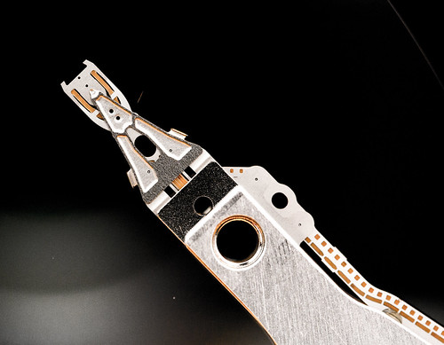

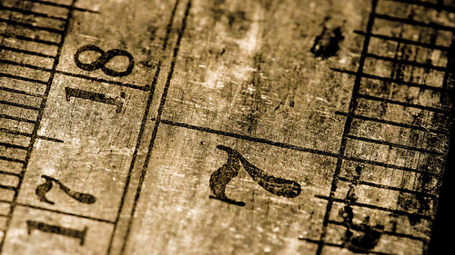

The Olympus 60 2.8 macro is the best lens I own. It is razor sharp with nice contrast with just the right stand off distance. Here is some of my work with
it.
