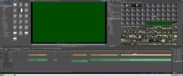

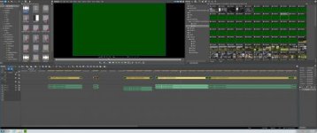

thanks for all post and grest1 advise. i just did 4 weddings so i got my camera friday and starty shooting 1080 60p for 2 of the weddings and 30p 1 wedding last yesterday i did ultra 4k 30p . no problem till last one yesterday i was trying some slow motion in the groom room than jump back to 4k and all the 4k files is orange only audio no video. not sure what went wrong i play back at the park and i did not see the 4k from grooms room. so today i download both card and just get the orange screen with audio any one have this problem ?. i did get 3 clip in here is the screen grab from 2 cards .Screenshot 2016-07-05 12.15.39.jpgScreenshot 2016-07-05 12.17.03.jpg
update i put the card on diferent pc and there they are so i am happy. any way my thought on this camera that is well build and i got use to all the menus and togle swicth close to my ag 160 but way way better . love the touch screen and that you can swicth the kelvin,gain,shutter,ect while recording. i wish low light was a bit better but it not a problem . happy camper her. i need to download scene file from barry green.
