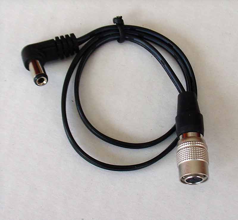

Absolutely. The only thing you need is a cable to power the NF (Hirose plug). We already shipped a few. The battery will power both AF100 and NF for about 1 hour 40 min.
Just a quick note, the first version of the cable had a tight fit due to its straight battery plug; we just tested a new right angle plug, which worked out great. If somebody wants to exchange one that we shipped recently, please contact us, will be happy to do it.
Hello ADolgin,
I received my Thursday from Dan Keaton and it works like a charm. I am in the process of doing a battery duration test now. Great cable solution, great price.
Glad it is working out for you. You should be getting almost 2 hours out of these batteries while powering both the camera and NF.
