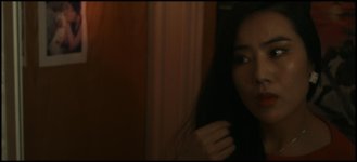

48hour film fest at the weekend was one of my first crack with the F3 in anger. Cine1, 3200ISO nikkor 50 1.8 (£39) 10bit422prores to recorder.
I guess Ill post some more as the thing comes together.
lights: camping shop practicals, and my new dedo Dled4.0 through a 4*4(ft) scrim
Single pass in Resolve no secondaries.
looks really nice! moody stuff. would love to see some clips, or at least comparison frame grabs of the same frame. can you post a still of the ungraded image as well?
Im cracking that, the dark image (above) not so much but him i was pleased with, im getting there with her now..
jpg ruins it!
For that dark image I might have brought down the intensity of that background light, it stands out a bit too much. But without it might not look great either.
You on resolve or grading with something else?
I took the light through the window as sodium vapour look. Now I feel like ass.
Resolve is great.
Yep I gelled the window yellow to make if look like sodium - actually it was daylight - but I could not 'turn it down'
(well I could have cranked up the internal lights if I had more of them)
