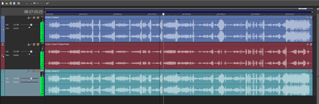

I filmed a performance on Saturday. I used a Zoom H5 to record the applause and space, while recording a board feed to a Zoom F3. The strange part the H5 was in sync for the first half of the show but in the second half it's badly out of sync. I thought I could change the speed to fix it but it looks like the speed wasn't consistent so instead of chopping it up and trying to sync it that way I'll just use one of the on camera mics. Really strange.
Zoom doesn't specify a clock stability and it is a budget recorder, so the clock they put in it, well, who knows how stable it is. Also note that you really don't know what is drifting. You have multiple devices recorder and as I understand it, none of them are synced to one another. So the drift is relative. The camera may drift one way while the Zoom drifts the other way.

I uploaded mp3 of them to Dropbox, maybe it's something I'm doing that I'm not seeing.
Zoom H5 recorder that's out of sync
Camera 1
Board feed recorded into Zoom F3
Yes, Peter. I see your problem.

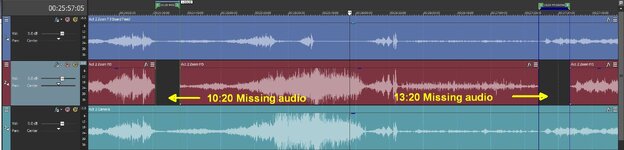

The three files synced and drift corrected in about 20 seconds in Pluraleyes. But that revealed a problem. The H5 has stopped recording twice. Once for 10:20 seconds and the second time for 13:20 seconds. The gaps were easily repaired by stealing from the camera file and adjusting the repair inserts. Final sync checks and tweaks were done in Resolve using Elastic .WAV. Check the attached before and after JPGs to see what I mean. I will PM you with a download link for the repaired files. They will be in MP3s in a ZIP file. Good luck!
Wow Chris your amazing. I would never have believe that it stopped recording. Must be a defective recorder since I pressed record and let it go for the entire event. Very strange indeed. Thanks so much you're the best.
Yes, when I saw the files out of Pluraleyes, I could see there were synced file areas and big areas with no sync. Which generally means there is no other audio to sync to. I've never seen drift issues in the ranges of 20 + seconds. I think about the worst I've seen is up to about 2 seconds in an hour. So knew there must be an issue if the software can't find a matching waveform in any of the other tracks. It was easy to pick the big gaps. :)(y)
