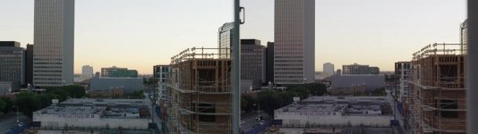

Well I have both cameras here getting some dust so I decided to play with them.
Some comparisons coming:
Amira on the left, F35 on the right. Veeery close to me. (download for full resolution). With the Davinci Alexa-709 lut the blues are a bit more electric than they should but easy to dial down, so I wouldn´t worry to much about that.
The Amira applies some kind of sharpening that makes the footage look like a nice 35mm scan. The F35 seems to resolve more details and shows no traces of sharpening. Interesting.
I am going to test setting the F35 on F900 color gamut instead of Sgamut. I think for normal users it might be better.

Both images are insanely filmic, just shooting a random object with absolutely nothing cinematic about it. They both really are quite remarkeable for digital images as someone who used to shoot 35mm.
So which package the Amira is in the test? 1080p, 2.8k or 4k (upscaled 3.2k) ? Recorded internally? To 4:2:2/4:4:4?
The F35 does scale down from a higher resolution sensor (5k vs 3.2k in UHD and 2.8k in 1080p), huge resolution difference, so I am not surprised if it does resolve more than the amira when both are delivered in 1080p.

Alexa on the left? really? Judging from these grabs, The image on the right is markedly better, better resolution without digital sharpening effect, better colors and just a better image to look at to my eye (there's even slight moire present in the left image on the left building). Same with the video but the difference is much more clear with the stills.

Took the images in Vegas and looked on a calibrated highend Eizo monitor,
first of all, apart from these specific cameras, I am extremely impressed with the JPEG compression quality. I mean I can puch the shadows, bring down highlights, push and pull the image with no and visible degradation in quality occurs from what I am used to from these cameras. Only issue is banding from an 8bit container, other than that I think these Jpegs do represent the actual quality. Is there a secret to getting such HQ Jpegs mac? Mine are certainly not!
On to the images, the F35 has a significantly more red in the mid tones, while the Amira has less red (more green-ish), so to match both images I reduced the red in the f35 midtones just ever so slightly, and they match perfectly, at least here on my monitor.
The resolution: these images are extremely close, in all respects. There's a very minor resolution advantage for the f35 over the Amira image, but what's more important regarding this point, is that the Amira's image has a digital sharpening effect/look while the F35 shows no trace of that feel whatsoever, just pure organic detail. They're close anyway in resolution, especially if there's a setting on the Amira to turn off the sharpening.
The colours are also quite similar here, where they differ radically is in the blue palette, the blues in the Amira image don't look realistic at all, film doesn't show blue in that cartoonish way if I may say but it can be corrected either way to match, not that easy though!
Dynamic range is the worst quality to judge here from a compressed jpeg, but for what it's worth, they are about the same here, with similar shadow cleanness and similar highlights. I am sure the Amira original image contains more DR than the f35, it should.
Artefacts, I can see there's no artefacts (aliasing/moire and digital edges) on the f35, even on the finest of lines, while the Amira shows a minor amount of moire on the left building, which is quite odd, it shouldn't do that should it? It's a pretty demanding pattern though to be clean.
This is all I could gather from these JPEGs, that they are pretty damn close, but the f35 is very slightly just better overall. (More files please! Hopefully 16bit Tiffs to really judge DR accurately)

The Amira has debayering level detail and sharpness settings. The "Detail" parameter seems to be how much luma resolution the debayering algorithm adds back into the image.
You can get incredibly snappy images on the Amira by upping detail to +4 or 5.

The Amira has more DR than the F35, hands down. If I look closely at the blown out window I get to see like more stop at least (and I bet there's at least 1 more stop in the shadows). And the Amira shoots 50p, all the way up to 200fps! And it does 800ISO and decent 1600iso. And it has built in ND filters. And records internally in a very nice codec. I mean, the clear winner is going to be the Amira of course.
Now, for the current price of the F35, look how damn close and how good the F35 looks to the Amira. I think it's a bargain.
Regarding sharpening/detail. The F35 resolves more with zero unsharp mask artifacts. That's astonishing. The Amira/alexa can't get that level of detail at 1080p. There are pros/cons with this though, as the slightly softer image of the Amira/alexa in 1080p seems more like film stock (I some times blur the F35 a little bit in post and resharpen it to get this effect to emulate film stock), but this F35 advantage is great when stabilizing or resizing shots because you´re not enhancing sharpening halos.
Properly exposed they both seem to show the same level of noise. I can see that in the couch for example.
In low light conditions the Amira is better, the F35 needs more light for some reason to look good.
The F35 produces warmer pictures than the Amira (and pretty much any other camera). It´s a topic we've discussed before. You need to cool it down in post to get the right balance.
I was also surprised to see how similar the tone curve on the Amira+davincinresolve lut looks to the F35+myslog lut.
If you noticed it I didn't even mention which camera is which on the clip I posted. That's for you to decide (you can probably tell by the blues or the detail).
But it was a good test. Now I can shoot with the F35 with enough confidence to say that the end result will pretty much look the same as if I had shot on the Amira/alexa.
