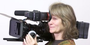

Good points Ben,
I am going to make sure the extension unit will work with my kit. I may bend the back down a bit if necessary and even add a VCT-14 tail hook there.
What I do if I need more counter weight is add more IDX batteries, they stack. The same as I do on my FS700 and EX3 kits. We also can ship a bag with the back angled cheese plate that can hold spare batteries or any other weight to balance rigs.
Here is a photo of Sharyn with my FS700 kit showing dual IDX batteries and FF. This is with a Metabones adapter and 24-70 f2.8 L Canon lens.
