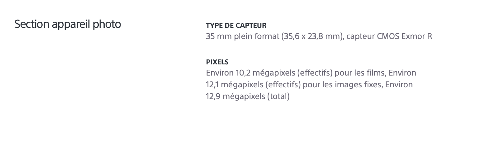

The sensor is not 18.8 high, it is 3:2 FF 24x36 and able to output 24x36 in still photo on the FX3
I'm just wondering if the full sensor read out, which is possible in photo, would be possible in video and what are the limitations to achieve this

Okay, sure. If you want to shoot anamorphic stills, then you're going to need larger format glass to cover the extra sensor height.
If you want to shoot anamorphic video, see my advice in the previous post.
