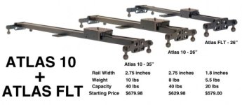

Oh, just remembered this image, lol.
If you're unsure, this might help. Keep in mind, the sliders in the image are just with the regular or standard legs - though they're all compatible with the All Terrain leg system
You can see the image in the Ask Cinevate blog post 'Atlas 10 and FLT' here

Thanks for replying!
I currently own a Manfrotto 501 (not the HDV) Video head which is supported by the Manfrotto 755b legs.
So it's definitely older.
Judging by the image you posted, it looks like the Atlas 10 FLT, being the lightest, would be the best choice for me. I'm not positive on the amount of weight the 501 can safely hold though, I thought it was around 13 pounds? So it may be cutting it close.
I definitely prefer the Atlas FLT. Though it is a bit shorter than the Atlas 10, it's much lighter. I tried finding the older 501 head you mentioned but was having a hard time finding the specs/weight capacity. Depending on your budget, you could use your 501 head on top of the Atlas and get a newer head for underneith (preferably with a higher weight capacity if you think the existing head is too weak). Definitely check out the video in the link I posted though, I cover some other mounting options on top of the slider :p
