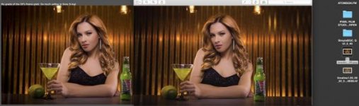

Here's my Slog-2 Grades,
[/IMG]
[/IMG]
F65 SGamut Slog2 => rec709 Slog2 LUT in PS. Gamma/contrast adjusted manually with curves etc.
Various tweaks in PS including removing NR artifacts from skin- curious what the noise looked like before NR (added noise in PS after fixing skin).
Goal was natural looking skintones vs. anything dramatic. Monitors calibrated using X-Rite i1Display.

Photoshop? Do it in Resolve. And those frame grabs were s-log. And why are your Jpegs shifting that much? WTF?
Lol- when I launched Resolve (latest version), it locked up (never happened before, didn't want to spend time debugging the issue). PS can load LUTs, so used PS. JPEG color issues are common (especially in different browsers), most noticeable with skintones. PS has far superior color controls vs. Resolve, and can even be used on video (very slow at this point).
Regarding yellow in SLog: if you use SGamut, it's important to use an SGamut to rec709 LUT to get back into a 'normal' colorspace (vs. ultrawide gamut).
Uh, I don't know a single person that would grade a project in PS, much less ask for their project to be graded in PS. I mean, unless you have a month for turnaround. Can your PS grade do power windows? Tracking? Qualifiers? How about playback with your director sitting there next to you on a complicated color grade. Will he or she be happy with the render times?
Jpeg color issues? Your shift when you first posted was so wacky. I don't seem to be having any issues. If I load this page, my Resolve window, and the exported Jpeg I used for this post sitting on my desktop, they all look identical. It's called color management.
Screen shot of the DVXthread and the Jpeg used to upload (including the screen shot too which is a PNG).
Graded using Filmconvert with very minor tweaks. Used Kodak Vis3, reduced grain, film colour at 90 and film curve at 90. Some slight colour correction.
The shift wasn't that dramatic- I ended up moving back to warmer as trying to get closer to a normal skin color didn't quite look right when lit with so little blue light. While I had turned off Convert to sRGB, I left the embedded color profile, which apparently works better turned off. Googling this: appears to be a big issue: https://www.google.com/search?q=photoshop jpeg color shift .
I test everything and use what works best. For stills, PS is the best tool for the job, by far. I'm not an expert in Resolve- how do you quickly adjust color temp (without manually messing with RGB scale/offset via LGG etc.)? Super fast & easy in PS (ACR filter) or PPro (Fast Color Corrector). Resolve is pretty cool, but also pretty archaic compared to other tools. The earlier lock up was due to some kind of problem with Resolve's QuickTime interface (it will ultimately load after a long delay).
Couple quick grades in Resolve 11. First uses F65 SGamut+Slog2 to rec709+Slog2, second uses Alister's Filmic2 1 OVER LUT. Both tweaked further after LUTs applied. Again, goal was accurate skin vs. any kind of look (second example has a bit of 'look' due to LUT used).
Another PS version after web viewing (everything looks much better in PS vs. viewing in browser (Chrome on Win7)):
Ideally color tests should go for skin tone accuracy first so we can see if all is correct (not easy!), followed by any looks for the story / emotion (easy!).
