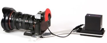

I am almost done with a whole kit for the A7s.
One of the key parts is the external power. I use either Sony/Swit 7.4 v batteries or IDX/SB bricks converted to 7.4v to power the A7s.
I can supply just the dummy battery and plates with long cables so you can just keep battery in a pocket or on your own rig. Bigger batteries can even power recorder like the Odyssey as well as the camera and even a light.
You can contact me directly if you need the power solution. The whole kit should be done in the end of this month.
Photos are of a prototype a while ago.

My kits send 7.4v. Yes of course you can buy the parts on Ebay and put it together yourself. I buy the dummy batteries by the hundreds and I use the battery plates for many different solutions, so I buy those in quantity as well.
What I do is put it all together so it just works, and I combine it with my A7s kit. And that kit will actually have a wood handle on the right that makes the camera a lot more comfortable in the hand but still allows access to everything, and the shoulder part with the optional battery works with the built in WF. Any one with a milling machine even a manual one can make these parts. But not every one has CNC machines and want to program them. I also do a lot of custom building for shooters like myself.
I will post pictures here soon of the finished kit. It will also have an optional top handle for low angle shooting and balanced carrying.

This is my simple external power solution.
I have this solution in stock now, I can furnish a long chord as well. This plate uses Sony 7.4v NP batteries like in the FS700. I can supply with Canon or Pany batterie plates as well. Kit uses a dummy battery. I can also sell you just the dummy battery, so you can hook up your own solution.
This is all part of the kit I am building for the A7s. If you are interested contact me directly. The whole kit including wood handle on the right will soon be available.
