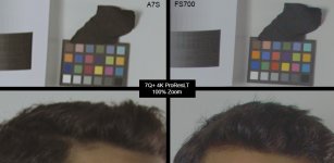

I was doing some tests comparing my FS700+7Q+ 4k to the A7S+7Q+ 4k and noticed the A7S is way softer than the FS700. I thought maybe my lenses were out of focus for the A7S shots but that doesn't seem to be the case. I will test again, but has anyone else seen this? Granted, the FS700+7Q 4K is crazy sharp maybe partly because of the fast debayer that might also mean it aliases a bit, but in my quick tests it the FS700 4k made the A7S 4k look like 2-3k...

Actually I was just comparing the A7S 4k prores file to the FS700's internal AVCHD file and they appear to look almost identical in sharpness and processing... Maybe for some reason the 7Q+ was only getting a 1080p upscale from the A7S? Hmm, must retest I guess?

Hmm I just tested shooting a resolution chart in XAVC and in UHD ProRes and the ProRes is clearly sharper... I wonder if it was a processing problem with the older 7Q+ firmware when I did the last test? I should test it in good lighting against the FS700 again since clearly something went wrong last time. It is a bit concerning though that there is any way to end up with a UHD file that seems to just be 1080p uprezzed.

I meant were you in APS-C mode. If you are then 4K is less sharp as it is up sampled. In Full frame mode C mode is actually superior in some ways, less jello and possible less moire.

In my observations, the FS700 4K is sharper than the A7s 4K but not by a huge margin and not enough to be concerned about.
Downsampling a 4K externally recorded ProRes to HD does make it *much* sharper than any internally created HD however.
