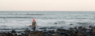

From a beach scene we shot this weekend in Maine for our feature in progress - we're 66% done with principal! No CC yet.
GH13 (hacked) avg bitrate on these was really nice and high 45mbps solid or even more.
Lenses:
OTS shots - Samyang 85mm f/1.4
Wide shot against rocks - Canon FD 24mm f/1.4 L
Shots on beach - Zeiss 50mm f/1.4
Panasonic 1.33x adapter
Lots of Nikon ND4 filters (stacked - as many as 3 of them)

I thought these looked a bit soft for GH13. Any chance the stacked ND filters softened things a bit?
These are super duper compressed and downscaled - the avchd looks awesome - anamorphic is definitely a touch softer than when shooting aspherically unless you stop down massively. I did have two shots that I shot without anamorphics on this - here's a couple grabs and I was using stacked NDs here too.
EDIT: Didn't mention the lens - this is the Zeiss 50mm f/1.4 in Rollei SL35 mount (west german made).

I'm very happy with the Nikon NDs, but I mean, there's no way you can stack 3 filters and not lose any sharpness at all, but I'm really picky about filters and sharpness and I find these NDs even stacked to be quite good and work within my sharpness requirements. I'm also using old glass for the most part so it's not as sharp/contrasty as modern lenses to begin with - this is a narrative work and I didn't want hyper contrast/sharpness - I brought a Canon 70-200 f/2.8 L with me on this shoot but it was just too sharp/contrasty for these scenes so I couldn't use it, would never match the others.

Thank you for following - anamorphic is not for the faint of heart for sure - I've used it maybe 40% of the time on this film - I absolutely love the look it produces but sometimes the lighting requirements for shooting anamorphic are beyond what I can produce on set as we are using a relatively low powered light kit.
It's also tough for me because I am a speed freak when it comes to lenses and I also like being up very close to the subject - neither of which can you do very easily with anamorphics (or at least, the Panasonic adapter - don't even try shooting faster than f/2.8 no matter the focal length - f/4 at least is usually the minimum for good sharpness and I often stop down further than that and shoot in the f/5.6-8 range - and of course, doing that pretty much guarantees deep focus - fine most of the time but if you want to go shallow with anamorphics on this rig it's a tricky proposition requiring just the right subject distance, focal length and aperture - far more variables shooting anamorphically that not - but the framing...I LOVE framing in anamorphic and I hate framing when I know I'm going to crop) - I must say that it's pretty cool though to have a GH13 tricked out with a Zeiss lens meant for a Rollei SL35 and a Panasonic Anamorphic adapter meant for a DVX100 and have it all work and deliver such gorgeous results when you do it right - nothing I use was really all designed initially to be used together - but that's what's just sort of great about the GH13.
In the end it's nice to use it when I can, but I often choose not to if it's going to take up so much time that something else on the project will suffer - the story and acting are far far more important than whether or not I shot with anamorphics.

Did you use a polarizer for anything? When shooting around HDR stuff like sunlit rocks/plants/talent you can dial down the highlights using the polarizer while keeping the exposure up. In the shot of the girl in the blue/white hoodie, the shoulder part is blown out while the rest is in fairly good exposure. You might have been able to dial down that blow-out some. Not really sure how it would work with anamorphics though.

The real issue you've gotta work with when using stacked NDs on vintage glass + an anamorphic adapter is controlling flare - I'm using a cinetactics matteblox with oversized flag and it works well, but at times I could even use more when I'm shooting with this many pieces of glass!
I have not used a polarizer on this project. As a rule, I'm not a big fan of filters, I come from a straight photography background and I've never liked anything at all in front of a great lens, and I haven't found a polarizer that I really love. Further to your point, a circular polarizer would be very problematic with my anamorphic setup as the adapter would then rotate along with it - it's hard enough that I used it with the Canon 24mm f/1.4 L which has a rotating front element (serious pain to readjust it every time I need to pull focus) - but I love that lens and it pairs so well that I just deal with it :)
On a couple of shots with the sunlight on the hoody it does indeed blow the highlights in a few parts of one of the takes - then the light changed and it didn't happen again - these stills are from a very rough cut I did yesterday and I haven't had a chance yet to go through over everything and work around some of those issues - but I should be able to in the end.
That said, circumstances being ideal, for a beach shoot I'd be using a really good polarizer in a mattebox setup - but the anamorphic setup I'm using just won't allow for that unfortunately.
