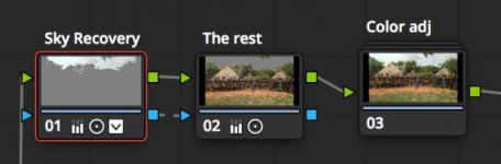

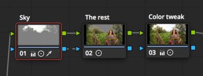

I did these quick edits in the free version of Resolve.
In the first node, I used a qualifier with low saturation and high luminance to select the sky. This was then brought down with the offset wheel.
Second node is an "outside" node, this selects everything that the previously qualified node doesn't have selected. This node lifts up the non-sky elements with the offset wheel, then uses the shadow and highlight wheels to bring contrast back into this area.
The third node is just a few small saturation adjustments on greens/blues.
When there's no way to avoid shooting in such harsh lighting conditions, these types of adjustments can bring back parts of the clips. We occasionally do this for some GH5 clips at football games in the late summer time. There are definitely limits to how far these adjustments will take you though.
