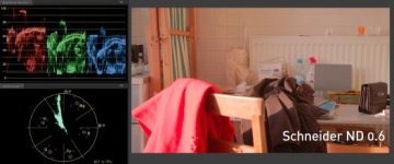

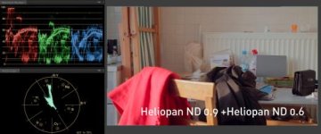

just got a set of Schneider 4x5.65 ND Filters in 0.6, 1.2, and 1.8 to go with my new 5D mk III. All water white glass.
On the mkII I used to work with Heliopan Vari Nds, but as I also need grads sometimes I decided to go with fixed NDs in a mattebox now.

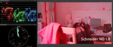

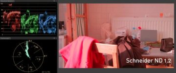

But I didn't expect this: starting already with the 0.6 there is a lot of red in the picture, making the filter unusable, at 1.2 hell breaks loose and at 1.8 I started crying.

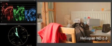

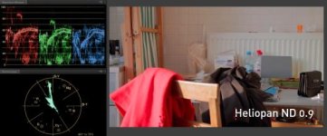

I still had some old Heliopan screw-in NDs, a 0.6 and a 0.9, hidden somewhere, so I tested with those. Both were really good. Even stacked.
So where does this red come from?
Is this IR pollution? Is it far or near red?
And what could help?
A Tiffen T1 IR cut filter? A Hot Mirror? Sell the Schneiders again and get Schneider Platinum IRNDs or Tiffen IRNDs?

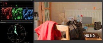

Please see the pictures yourself and also have a look at the vectorscope.
Everything was shot with Stu's settings and I only threw in a little saturation in AE, nothing else.
Did anyone of you see this before? I never had something like this on the 5D mkII, unfortunately I don't have one anymore to test against...
cheers,
Martin
