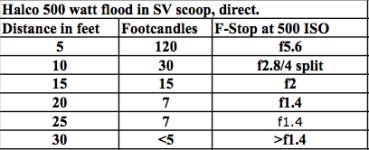

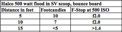

First is in a standard high wattage scoop light:
Photometrics, direct light:
Photometrics using the light from a bounce source:

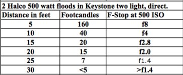

In a two bulb high wattage fixture:
Two light photometrics:

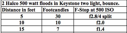

Two light photometrics from a bounce source:

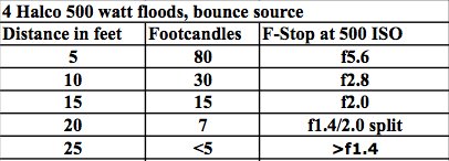

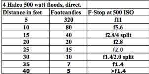

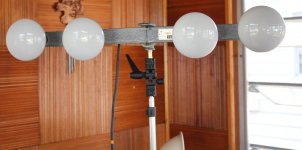

And in a 4 light confirguration:
4 light photometrics, direct lighting:
4 light photometrics, bounce source:

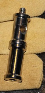

Just as an FYI, the two light and four light fixtures are vintage movie lights that I picked up off of eBay. I have collected a lot of fixtures like this and made a rule to never spend more than $20.00 on them. Go to eBay and search "Movie Light" in "Cameras and photo". These vintage fixtures almost always have a 1/4 20 screw hole in them and to make them useable for lighting, I have picked up some umbrella light stand adapters:
These come with spigots:
that I screw into the 1/4 20 tap in the base of the light fixture and secure in the umbrella stand adapters. The adapters give me the ability to tilt the fixtures as needed.
