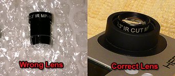

Finally, if you do decide to get one of these somewhere that doesn't charge $375 for them, be warned that there are 2 versions of the 5.4mm lens and getting the correct lens DOES matter.
1)The "IR" version is meant for putting on CCDs filming at night where there is a infrared light shining in the area - this is the WRONG lens and you don't want it for daytime shooting. If you purchase this lens by mistake, you will get footage that is bleached pink like this:
2)The "IR CUT" version is the CORRECT version that you want for putting on a GoPro to film in the daytime.
See the sample photo below so you can tell the difference between them:
