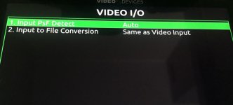

Pix e5H I/O settings "same video input" and it records 1080p50 prores movies.

I changed I/O Pix as follow
INPUT PsF detect>Interpret PsF as P
Input to File conversion>PsF to P
and I got a 1080PsF25 (i>PsF PsF>P)
SOLVED issue is PAL land 25p.
