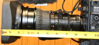

Ned - that would be great as I'm also considering a purchase. Also any notes regarding the camera getting front-heavy with the adapter (if it's an issue) would be appreciated. If you could snap a photo or two, I'd also love to see it. Finally, if you don't mind sharing what your final cost was - including the rubber sunshade (if you don't, I understand).

Stay tuned, got busy, just did some tests in my office. Not up to Barry Green standards but played with distortion, rez on the edges and CAC on & off. Laying it into a timeline now, will see how big a file it is and will upload, probably to Vimeo or Youtube tonight!
Looked good so far although most of what I was viewing was in the LCD viewfinder.

Nice! That is my main complaint when I shoot with the 300, that stock lens is just not wide enough. Can't wait to hear the Ned appraisal.
