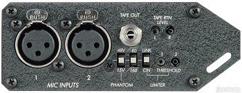

Doesn't your MixPre have a "Tape Out" connector? You should be able to use a common 3.5mm Stereo to 3.5mm Stereo cable (Radio Shack has several models of different colors and lengths).
It does, but it doesn't work with my Sescom cable for some reason... forgot to mention that. It works from the Tascam just fine.
Good idea... any idea on finding a 1/8" y-adapter for converting 2 mono channels into a stereo channel?
I've never seen a mono to stereo 3.5mm splitter/combiner. If you must have a small adaptor, you can get 3.5mm to two phono(RCA) sockets - and if you were prepared to chop off the 3.5mm plugs and swap them for phonos, that would work.
If you are using the "TAPE OUT" connector on your MixPre, then you do not need a Y-cable of any kind.
You need only a simple TRS 3.5mm to TRS 3.5mm cable wired straight-across 1-to-1.
Richard: Maybe I wasn't clear in my first post or you just missed it but I'm trying to set up multiple configurations. The mix pre is only one configuration. I don't want to use the mix pre for run & gun. Thanks to you, I figured out that I was using the tape return and not the tape out from my mix pre, so now that configuration works perfectly, although it could just be me but I think the line out of the mixpre is slightly hotter than the line out from the Tascam DR100mkII

-- That's quite possible, most SD 'Tape out' connection are -14dB (nominal), don't know about the MixPre, the Tascam could be less or hotter. Depends on the input. You could look up the specs to see exactly.
This is typical for difference manufacturers. Nothing wrong with either way.
